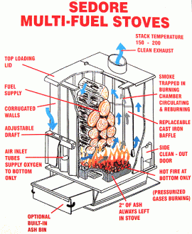

Sedore Stove -- originally (and still) manufactured in Canada --
This is a very interesting stove—burns just about anyting—chunck wood; pellets; corn; wood chips (!). Far as I know, it has a pretty unique principle of operation. The long burn time and very low stack temperature look promising. It requires a good chimney draft though.
Water heating coils for DHW or hydronic heat can be installed as an option behind the baffle. “ask us” the website says.
(broken link removed to http://www.sedoreusa.com/products.html)
(broken link removed)
I talked with the builder on the phone a while back. I think he said the stove had about a 60K BTU/hour output. Does that sound right?
I sure wish somebody would buy one of these and report back to us how it worked.... I'd do it myself, except I don't really have a need for it.

Wow, Fred61 -- pretty sobering. But thanks very much for speaking up. I'll definately stop trying to badger my friends into buying one just so we can see how it works....
There's a yahoo group (broken link removed) and they are chattering on about making bread in the bottom of the stove, and such like. No hint of serious, concept-canceling non-delivery of the goods....
What an irony -- your comments might be for me just about the most valuable thing I've come across in this forum.
So thanks again.
I think that bread baking thing is an inside job with a few suckers dragged along. You can bake bread in any non forced draft stove with a bed of coals in the bottom. There's nothing special about this stove. It's just a poorly engineered wood stove.

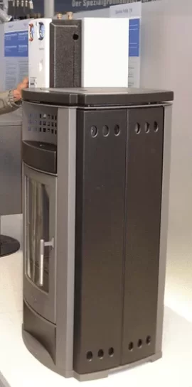

There are many parlor boilers/ stoves used in Europe. This is an example of a Buderus brand. I don't know of any that are currently imported however. Take a trip to the ISH show, in Frankfurt next week and you will see hundreds of them on display in the fireplace hall :) Many in operation!
Aquatherm talked about bringing in some of the Zenners a few years back, I suspect listings, liability, etc keep them from being imported. You'd be amazed what you can buy via the www these days.
