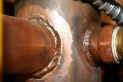

There have been a few threads on hydraulic separator's and P/S piping so I thought I would post some pics of my setup. The separator I made myself mostly because I of the custom fit, not sure it would save a
lot of money if you have to buy the pipe and count your time but I like to weld .......so here it is.

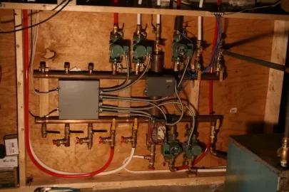

From right to left
oil boiler-pump mounted on boiler (not even hooked up yet
wood boiler 007 on bottom - pumps toward boiler return
storage 00R on top charges tank, 00R on bottom recovers
baseboard loop 1 - 007 on top
baseboard loop 2 - 007 top
All pumps pump away from separator
All loops have valves and boiler drains for purging. In the center are 2 used honeywell aquastats. Top stat controls storage, make on rise starts storage charge pump. Bottom stat break on fall shuts down loads to prevent
dropping wood boiler to low. This is about to change to some variation of the now world famous NFCS(nofossil control system). :coolgrin: The blue wire is cat5 to my 1-wire temp sensors

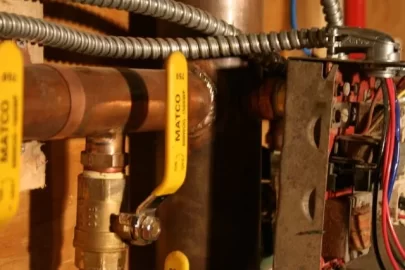

3" center section bottom is feed water supply & drain with shutoff valve(feed valve is off to side) top has drain, shutoff valve and pex to non bladder expansion tank overhead.
Extra outlets for upstairs loop, DHW and a spare. my DHW is now a side arm with boiler going through sidearm before it gets to the separator and it works well so I may leave it that way.
The large box contains my relays and 24v transformer. I used octal base relays and sockets mounted on din rail, makes a nice job and if one fails I have a spare just unplug old and stick a new one in.
I hope someone finds this usefull I have learned a ton from this site.
For the pro's here any comments or suggestions are welcome. Very happy so far but always looking to improve.
