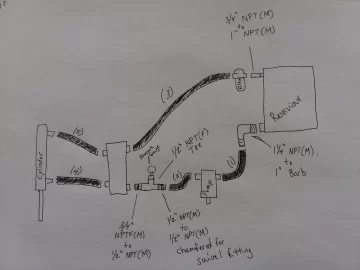

So my splitter is almost done. I just need to get some hoses made.
Now I'm realizing I'm going to need an array of fitting types and sizes. The pump output and pressure gauge are both NPT while most of the other parts are NPTF. Also the pump output is 1/2" while the valve input is 3/4". So I guess use a 3/4" hose?
I don't don't see any issues here, but I don't know much about hydraulics anyway. Is there anything I should know when hoses have different sizes and types of fitting on each end?
