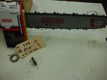

Rim was showing some wear.
Not real bad, but better to change while it's working than wait to long.
![Husqy 359 New bar/ chain & rim drive Husqy 359 New bar/ chain & rim drive](https://www.hearth.com/talk/data/attachments/87/87818-00b934f47ba34ef8b20bcb0c087a7fa5.jpg)
The bar that came with the saw, the oil hole started to plug up regularly.
New bar & rim so a new chain so ready to go for next spring.
![Husqy 359 New bar/ chain & rim drive Husqy 359 New bar/ chain & rim drive](https://www.hearth.com/talk/data/attachments/87/87817-5bbb84e3e6c72f338738e1030b655a10.jpg)
The piston lock was the only issue. I finally use the rope trick & the clutch popped off OK.
I did put anti seize on the clutch treads when I put it back on.
Dab of grease on the needle bearings also.
( I actually was able to throw the old chain & rim in the trash can.
But saved the bar. Never know, may get me out of a bind.
I bought 2 rim drives, one for the tool box.

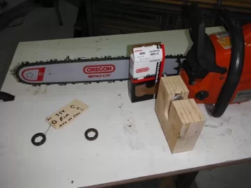

![Husqy 359 New bar/ chain & rim drive Husqy 359 New bar/ chain & rim drive](https://www.hearth.com/talk/data/attachments/87/87816-966206aa91112114e39f282d11dff578.jpg)
![Smile :) :)](/talk/styles/default/xenforo/smileys/grin.gif)
