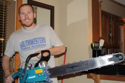

GET IT GET IT GET IT!!!!!!!!!
the 84cc kit from Bailey's is AWESOME...... turns a mild beast into a WILD beast! Long no more my man and pull the trigger! The thing cackles like a hot small block with a big cam.
  • [Hearth.com] Husquvarna 350 Problems and Price Check on a Makita 6401
