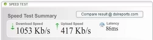

Wow, that's great. The best I can do for download is around 1MBps download on Sprint 4G mobile broadband, and I'm lucky enough to be near a tower.
  • Hughesnet internet service/ Does anybody hate them as much as I do?
