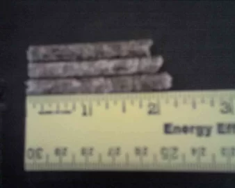

Has anyone experienced pellets of this size. These are CleanFire from PelletSales.com. Caused a jam last night and the stove went out. Cold when we got up. Sent an email to company but haven't gotten a response...

I would call them up and complain. If they state that they meet the standards of the Pellet Fuel Institute then I believe that the PFI has a standard of 1-1/2" maximum length.
So it is true after all; size does matter ;-)
You occasionally see a large pellet that made it through QC, somewhere around th 1 1/2" range. Is the whole pallet like that?
Steve,
Some further research shows that the standard for premium pellets actually states the percentage of pellets that are longer than 1-1/2" must be less than 1%.
So there can be some. I guess you would have to pull all the long ones out and weigh them to see if they total more than 1% of 40 pounds.

I have a ton of Northeast Pellets from Ashland Maine that are long, and they do cause clogs. When sifting, i break them up.

I'm having the same problems with these pellets. This is my first year burning and around bag number 8 my auger started getting clogged. I've been fighting it for two weeks now. I'm burning some diferent pellets tonight, stove seems to be running perfect again. I got the cleanfire pellets from pelletsales.com as well. Right now I'm burning some Greene Gold from Lowes, my father in law swears by them. He's been using them for 3 years now. There is a definite difference. The Green Gold pellets are smaller and also break up more easily. I think the clean fire pellets are clogging because the auger can't break them up. I'll let you know if my stove makes it through the night.
