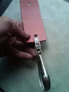

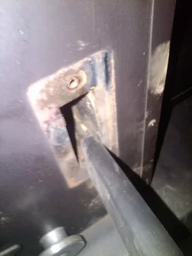

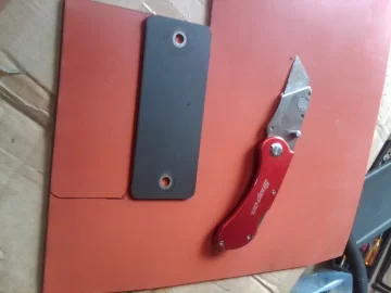

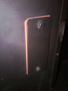

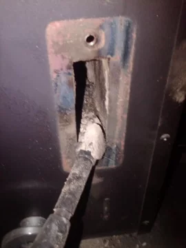

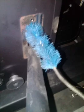

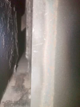

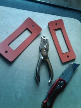

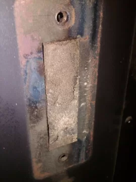

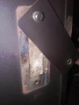

Well, this stove is 4 years old and used at least 3 seasons. They ash traps really do not seem like they have ever been removed. So I took them off and cleaned. Then made new Hi Temp Silicon Rubber Thick 1/8" gaskets for easy re-use. Surprisingly the inside was not completely plugged up even though the outside right trap looked jammed! See pics.
So how often do you clean? Do you have gaskets? These did not come with any! see pics below.
I used this material $14.71 and rated at 525 Deg F
These 12x12x1/8" Silicon ORANGE rubber sheets are a little softer than the red rubber with Durometer = 70A on the hardness scale.
