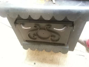

the stove [Hearth.com] How to test if my wood stove is worth installing? [Hearth.com] How to test if my wood stove is worth installing?

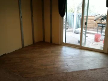

the location where it is going, before the wall is up

Welcome. Is the stove flue collar 6" or 8"? My concern is that this is a high altitude install. If the eventual goal is to have a more modern, cleaner and fuel efficient stove then a 12 ft flue is not going to cut it for most new stoves. Most need a 15' chimney at sea level. Pre-epa stoves are less fussy in this regard.
You can check the stove door gaskets with the dollar bill test. Close the door on a dollar bill. If it pulls out with no resistance the gasket is not sealing at that spot. If there is tension then try another location. Try all around the door perimeter. Also take a bright flashlight and look for any signs of cracking.

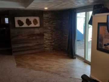

I got the stone all set up and the wall next to it finished!
