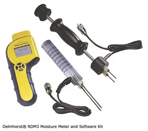

Or you can get one of these guys:
  • [Hearth.com] How to test for moisture in my wood stack

The hammer probe pictured in my post above is what pros use to determine the actual moisture gradient. The probes are insulated except at the tips, therefore, they only read the MC at the very deepest section of penetration. Two or three progressively deeper readings are taken, and the results are used to determine the gradient and the average MC of the piece in question. This is very important in the pulp industry since they are paying for wood fiber, not water in the wood.

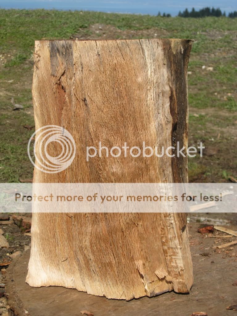

Here is a picture of what you're describing. This is a live oak round that was split after about eight months. The lighter colored wood at the bottom left was very dry but the darker portions didn't seem to have lost much moisture at all.

Yes, exactly- this is what I have seen so many times when splitting deadwood Oak. Looks dry outside, but turns out to be very wet on the inside. That split looks like it will need a year, probably lots more to be truly ready. Of course you'd probably want to split it smaller than halves like that. Almost seems like Oak that is never split would never season. Ever. Not the big pieces, anyway.
