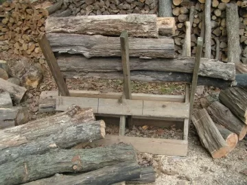

Several people (including me) have made stands that can hold several splits and then a chainsaw can rip through lots at once. If no one posts a picture of one Ill try and remember to do it tonight when I get home. Mine can do almost a wheelbarrow full in one shot.
Basically it is a box without a top or front mounted on four legs sized appropriately for your desired length. So in your case picture a plywood box with 36" high x 10" deep. Stand it on 4 legs, load it with splits, use a bungee to secure the splits and use a chainsaw to cut the splits to length.
Here's a pic!
H-Frame for cutting splits to length (PICS)

Post number 24. Others have made better than the one I built but it worked.

That is EXACTLY what I was thinking about, but I couldn't picture it. Thanks a TON!
One question though - on the pic you posted, had the logs shown already been cut? So you're saying you slide the chainsaw through the logs, sorta "sliding" down the front of the frame?

Yeah, they are already cut. Make the frame the length you are looking for all the way to the end (you may want to make it short an inch depending on your saw, bar length etc) and cut right down the front. Make it out of wood so if your chain contacts it you don't really have any disaster waiting to happen. Mine is cheesy compared to that one, made with scraps I had laying around but it sure gets the job done.

The splits in the picture were cut between 16 - 18 inches in the woods, the stand is made so that wood was cut down to 14.75. Make sure you bungee the wood down good (I changed to use two bungee cords, one in the back and one on the front) then cut it to length.
In the third picture you can see I cut them down. I started cutting before we even thought about having a woodstove, our Lopi Liberty will take 16 inches N/S loading but we like a few inches between the end of the split and the glass on the door.

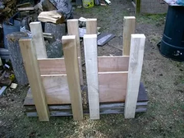

I made a stand like the two that were linked and like onion said make it about an inch shorter (in your case 9 inches) that way you dont have to slide the chainsaw down right against the front of the box, I made mine 16 inches as I like my splits 17 inches long. A couple 2 x 4's and some screws and you can make one in no time.
My setup is also in the linked to thread.
Here is what I made, kinda of like a giant miter box.
Load it up with wood and run the chainsaw down the middle,
works great.[Hearth.com] How to safely cut firewood in half (not split)?
