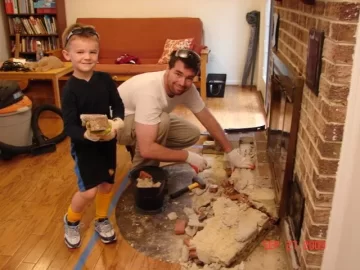

I found that when I removed my hearth, the builders had done exactly that, used the space as a dumping ground for rubble. The removal was so easy that my 5 year old went to town with a hammer and chisel and removed the entire lot. He enjoyed the demolition part immensely.

Correct. In my case my hearth was 3 bricks high. 6 bricks deep and 8 foot long. My son started at one of the corners at the front with a chisel and a maul and we individually removed each brick. about 6 bricks into it he hit it pretty hard and the whole front face pealed off.
I am at work now, yet if you are interested I could send you all the pictures of the projects progress, when I get home. The underlying floor had nothing adhered to it at all.

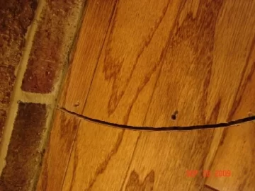

Ok, finally figured out how to reduce file sizes for posting. There will be a couple of posts, so here goes.
  • [Hearth.com] HOW TO REMOVE MY TOO-BIG HEARTH-HELP!

I have concrete under hard wood floor. The toughest part of the whole schbang was putting the Dremel through the floor the first time for the creation of the ellipse (being a surveyor, I was quite anal in ensuring that the measurements were spot on). Yet it was real quick in the end.

Hey Shari
I used the second to cheapest dremel that I could find. I did go through 3 wood cutting bits though. The little buzz box went through the stuff like a hot knife through butter. It turned out ok though.
Ray

Sure, no worries. Its pretty simple.
Go to home depot and you will want to get yourself 2 Cold Chisels (a 1" blade - stands about 14" high and has an orange hand protector around the top{you can see it in my photos if you look closely}, and also 4" blade - this one will be short and stubby). Also get yourself a 5lb maul, don't forget gloves and most importantly safety glasses.
Start off with the 1" Blade Cold Chisel on the first mortar joint in from the side. And start right on the front edge then give it a mighty wallop. It might take several blows before it starts to crack, yet it will crack. When it does move the blade of the Chisel down the crack in the mortar joint toward the glass fireplace doors. The more you hit the more the crack will expand. When you reach the cross mortar joint, where it the second brick begins stop and then move back to the outside of the mortar joint and start from the outside and work in. I've marked up your photo and will send it you as a PM so you can see where the start points are.
Once you have the first two mortar joints cracked then, from the looks of your photo, you are going to have to pickup the 4" cold chisel and start right on the very edge at the underside and give it another couple of good hits.
You are going to have to remove it brick by brick, yet once you have removed the first 3 or 4 you should find that it should go real quick, to get all the bricks out. If the bricks are tough to remove, you will find it easier to remove them in a staggered pattern, this will then expose 2 side and give you an outside corner to get the 4" under.
Don't worry about the concrete floor if it ends up with mortar chunks on it, residue from where the bricks stuck down, that is where the 4" comes in. A hefty 'angled' thump at the base of the chuck will clean it right off the underlying concrete.
From go to woe, it should take you less than an hour to beat the bricks out of there. Another hour or so to beat the chunks of mortar off and then another hour removing debris and hitting it with the vacum cleaner.
Remember, your best friend is your 5lb maul. If a brick is really solid beat the brick with the hammer from the side to 'soften' the mortar up a little bit and then use the 1" cold chisel.
By the looks of it, your fireplace door are like mine were. The glass is not built for heat and they will shatter if hot. They are ornamental in nature only. therefore, when running your fireplace always leave the doors open.
As for your mantle, remove the flat wood part (looks like wood) this will be held on either by 2 bolts or a couple of screws. It's 50/50 if they have gone through the bottom or top. Once the actual 'mantle' is remove then the braces are next it looks like the braces are the bottom brick is half in the wall and half out. This is the last one to be removed. the top brick is removed in the same way as the floor bricks. Use the 1" chisel on front face of the mortar joint. Then the sides, lastly the top. the bottom brick, of course is the hardest one of the whole schbang. Get your 4" Chisel and place it in the juncture where the brick meets the wall and (you are going to chop the brick off here) angle the 4" chisel so that you are running along the wall, remember you want to be right in the juncture of the joint. Give it a medium powered hit and then move to the other side of the brick and do the backwards hit. Then the Top and then the bottom (might be beneficial to have some hold the edge just in case the remains lands on your toe. If your brick survives all 4 hits then start the process again and until it shears off (Most brick layers I've seen do it in two or three knocks, so us layman will probably do it in double or then some). What will probably happen is that the brick will come off, yet it will leave a little pyramid (just beat it off with the 4" and the maul).
I should be a good morning project. Let us know how you get on.
