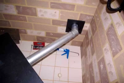

I have installed 4 stoves here at the ranch, all of them are direct vent too.
I really like having plenty of room to crawl behind the stove to work on the beast, cause sooner or later your gonna need to.
Snowy
  • [Hearth.com] How-To: Install a stove in a direct vent application
I might add here, one needs to make sure that you do not exceed the recommended horizontal run on the vent.
Mine is right at the limits speced out in the manual.
Its easy to use the leaf blower to suck out the pipe in a jiffy so no biggy.
Long horizontal runs will tend to fill up with fly ash, so one needs to keep an eye on it.
This stove will run fine for about 3 weeks between pipe cleanings.
Just AN FYI
snowy
