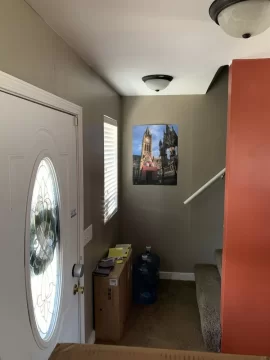

I'd love to heat the bedroom, which is directly above the carpeted area in the first picture. I was considering putting a large floor vent in the ceiling directly above the ceiling fan, which might push the hot air through it? I'm not sure though.
I really want to be able to heat the whole house with the stove, but I don't know what to do. I've attached photos of the house.
The bedroom is above the carpeted area in this picture, the hallway is above the vinyl area. Perhaps 1 floor vent to the bedroom and 1 to the hallway? And the staircase could be the cold air return?

Heat starts to stall about half way up the steep staircase (tried using a box fan to blow cold air down, but it gets even colder upstairs)

With the way your home is designed heat will never go around the corner and up the stairs. Even cutting in the floor vent you should have a small slow fan in the vent to help create the air flow and pull some heat into the upper levels. best location for a vent is the wall directly across from the stove it will have the most heat
Reactions: creztor
Would you say this red area in the top left or closer to the stove? I think that would be in the front left corner of the bedroom (so directly to the left of the door to the bedroom). Slightly closer to the stove would be more towards the center of the bedroom.
