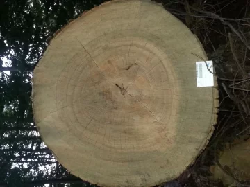

X2If I ran across a score like that I'd sure as he!! find a way
maybe cut it into smaller sizes
I would cut into 18" logs then using wedges split in half, if your lazy you can also noodle in half, looks like its all big ash, so it would be as heavy as oak in that size.
Yeah, it's dangerous bucking on a stack of logs! Or use a peavey to roll the logs to the ground first.just be careful of the rollers.
I have loaded my car, passenger seat, back seat and trunk full of dry 16" splits, about 1/4 cord, but it's a big car and I didn't have too far to go, so could drive slow. Still way over the rated payload. Borrowing a truck would be the way to go on that wet stuff...what is the max length I can cut to get in my car, weight wise?
What do you mean when I get older, I am 62 and will out split by hand most people my age and/or maybe even the younger folks. Like doing it that way and always have.Tigeroak , well when ya get older you will be trading in that maul on some powered equipment-
Hey, that's a good idea! Thanks.Or, more easier, you can noodle a groove the lengh to the round (to serve as a parting-line), bar-width or so deep. Then set wedge(s) and halve it. Converts much less wood to chips/noodles. Saves fuel & saw, speeds things up.
