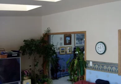

My multifuel stove is unfortunately located in one end of the house so its hard to get the heat moved to the other end. As you can see in the pic a lot of the heat gets bottlenecked in the living room due to that dropped section of the cathedral ceiling. Can I make some sort of boxed cuts in that section and get a noticable amount of heat movement. The hallway that is just behind the doorway pictured to the left has a similar smaller dripped section that likely does the same thing. Currently as last season I moved heat with a small box fan on the hallway floor blowing towards the heated room. I would like to mount a small fan up there to help move heat down the hall by pointing it in the other direction. Is doing this worth the effort? I had thought of hanging a ceiling fan in the area in front of the stive but I doubt that that would do much to get the heat down that hallway. Any ideas from you HVAC or builder sort of guys?

It would definitely be worth a shot. First I would make sure that the place you want to put the vent is not a major load bearing member of the house. If it is, there is likely to be a solid header in there that you can't cut. If it is non, or minimally load bearing, there is probably some open space. The easiest thing to do then would be to "thump" the wall with your knuckles to map out the hollow spaces, cut the sheetrock away on both sides of the wall and install a couple of nice vent grills. If you were really crafty, you could wire a small fan inside the vent for added heat transfer.
As a last ditch effort, you may not be able to go above the doors because of the headers, but may have better luck going straight through a wall for two adjoining rooms...depending on how your floorplan is.
