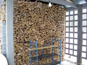

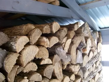

Ja, I stack my wood 9 feet tall in my woodshed and I've seen that phenomenon when I stacked very green wood rows right tight together. As the face row shrank, the edges would catch on the previous row and also the exposed face dried and shrank at a faster rate than the backside causing the face of the last row to curl away and topple.
I stack right tight to the rafters and have seen as much as a 9 inch gap form as it shrank. Given the height of 9 feet, that is about one inch per foot so 1/12th or 1 cord lost in 12 cord to shrinkage. I don't usually stack green wood in the shed, preferring to leave it loose piled out in the sun and wind for a few months first. Here are a couple of pics of wood that sat out first. There is less than 4 inches of gap.

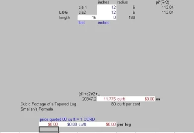

I put a spreadsheet together for buying logs using Smalian's log scaling formula
