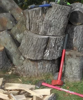

Ya know I was looking at that in the flyer yesterday - that certainly is a good price.I didn't want to comment on your need for a splitter, given the size of your rounds in the photo. BUT since you mentioned your splitter, TSC has a fast 25 ton model on sale- today is the last day for $200 off. Its a goog price and lots of tonnage and TSC"s great warranty. For the money, this is what I would get if I didn't already have one.

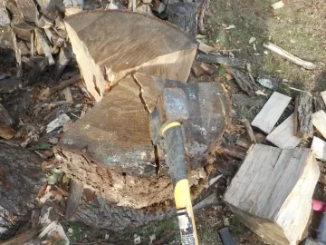

12 lbs maul...? My shoulder hurts at the thought of that! I've used mauls in the past (6 lbs and 8lbs) and none of them were sharp and all of them got the job done. I broke my last maul about 3 years ago and replaced it with the Fiskers splitting axe. The Fiskars is much sharper and lighter, but worked better in my opinion. I've never even thought about sharpening a maul before...The maul I have in the photo (on the ground) is I think 8 lbs, it's the one I use most of the time. Should it be very sharp or somewhat blunt? The one upright I think is 12 lbs, when I bought that it was not sharp at all so I assume it should stay that way.
I have what looks like the same maul. It bounced off the wood all the time and was really frustrating.
I bought a Fiskars x27 (lightweight splitting axe) that I use for most of the wood and the Fiskars 8 pound maul for the tough stuff. They're fantastic. I'll never use that red maul again.
The fiskers maul is not just sharper from the factory, but the blade shape is more concave so it enters the wood better instead of bouncing off. Even if it doesn't split the wood it usually goes in solidly and you can hit it with a sledge after that.
My Gransfors maul came very sharp. I would think it only cuts the first inch, then it is the wedge function. But being sharp leaves a little more momentum for the split.
A splitting axe shouldn't be used as a wedge. On the vast majority, only the cutting edge is hardened so it will mushroom the back of the axe. A maul is hardened front and back. My old maul was 8lb and my gransfors (photos on another thread) is 5.5. I do better with the lighter maul probably due to getting it to higher speed before contact. But I also use a regular 3.5lb axe for easier stuff. But I never pound on it. I don't pound on my maul either. I pull it our and reswing. sinde note: I was working with a friend who does hydraulic on everything and he was impressed how fast you can work by choosing the maul over the hydraulic on alot of these.
