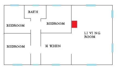

Well, I'm setting my expectation for this stove to only heat this one room, the living room. The living room is connected to the kitchen via an open doorway (i.e. no door, just a standard size doorway) but otherwise is isolated from the rest of the house. I drew up a quick and dirty sketch of the layout, with the red rectangle showing there I am planning on placing the stove.
(I added a sketch below.)
There may be some minor heat benefit to the kitchen, and to a bedroom on the opposite side of the wall from where the stove will sit, but as you can see the layout is not ideal for counting on the stove to heat anything more than just the room where it's installed.
So, given that the stove isn't really going to be heating more than just the living room, I guess that would argue away from the F3CB, eh?

BrotherBart has the Nordic and likes it. He also has the F3CB, so it would be worth PMing him for a comparison. The F100 will mean smaller firewood than the F3CB, but other than that it appears to be a nice small stove with a nice fire view. The Jotul 602 is a fine small stove. It will need to be fed a bit more frequently, but it can heat nicely.
I think you can heat more area and alleviate some of the heat build up that may happen in the living room by taking a table fan and placing it on the floor at the entrance of the lower left bedroom. Point it towards the living room and run it on low speed and it should start heat circulating through the kitchen and to the hallway. Use this together with a ceiling fan and the stove should have a nice overall influence on the house warmth.

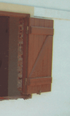

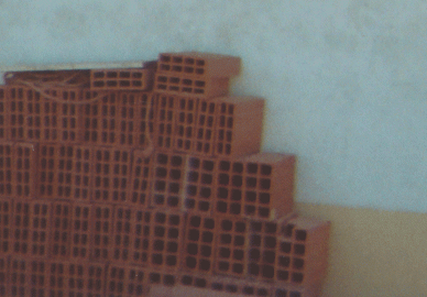

Digging up this old thread again, because I'm starting to think a Jotul F400 would be a better choice, but was hoping to get your opinions as to whether I am going to regret going larger than the F3CB. First couple of my posts in this thread have some details that I won't repeat here, but a few additional pieces of information ...
(1) I did a little more research to try to find out exactly how poorly insulated this cottage is. I managed to get a hold of a couple of photos that show the very thin (in my opinion) bricks that the place is made out of. These bricks are mostly hollow -- so I was probably overstating things when I incorrectly said that the walls were "concrete block." See below for the image of what the walls are made out of. I don't think there's any insulation at all in them. I know it's poorly built, but it is what it is for now, and this is the construction I'm working with. So the "insulation" quality of this place may be even worse than I thought. I really want to avoid getting the F3CB and then finding out that on a 38-degree, damp, windy coastal winter night it can't even keep the living room cozy.
(2) The layout I sketched up was somewhat incorrect, in that there is a much bigger opening between the living room (where the stove will be located) and the kitchen. Instead of being a standard doorway sized connection, it's actually two or three times the width of a standard doorway, making it almost like one larger room, probably about 500 square feet for the kitchen/living room combined. And I may be able to get more warm air into the other parts of the house than I was originally thinking.

I don't think it would be a bad idea to get the F400, especially if you vent it straight up with at least 15' of pipe, which sounds possible with the high ceiling. The more common complaint we hear here is that the stove is too small for the task. This kind of issue typically starts showing up when it gets cold. You will like the F400. It has a nicer fit and finish and a better air control.
Besides being uninsulated, I wonder how well that window is going to seal. Is there no glass in it? If all ten window openings are of similar design, that could be an issue and would further warrant getting the bigger stove. I'd also consider making some clear plastic temporary windows fitted with a good seal.
I should have specified, that photo was taken when the windows were being replaced, they do have glass, actually double-paned glass (so the windows may be just as insulated as the walls!). At night we close the wooden shutters so it adds a big more insulation on top of the glass windows as well.
