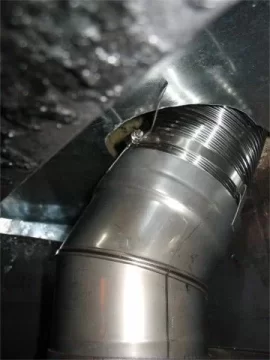

View attachment 116365 Most of the time you don't need to do that. Angle the liner at the smoke shelf and use a stainless fixed elbow coming off the top of the stove.
Mine is that same way.
