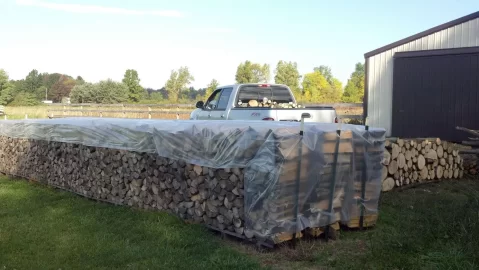

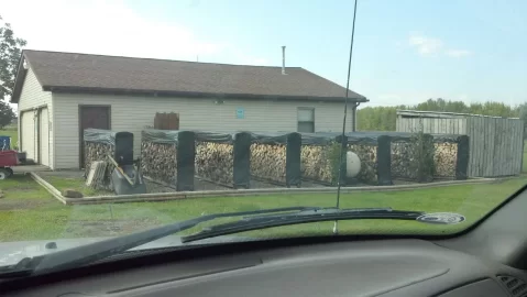

Wood stored under cover (i.e. - Indoors) will have little to no fading or greying. It will check some. But the wood in my stacks,by the house, is all the same age (within a few months). Some was stored outside since day 1, and a lot was stored in my barn for about a year. The wood from the barn has a lower M/C and looks like it is almost fresh cut.
The other pic (one large stack with some unsplit rounds) is wood that was split this Spring/early Summer. It's also kinda grey, but nowhere near ready.
That wood you have seems to be a little wet. Even without the noise, the smoke rolling around in the box is a good indicator.
