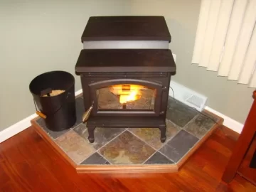

I have a 1100 sq ft raised ranch. My stove is in the living room. I just purchased a breckwell p23 which does 2200sq ft or 45k Btu. I recommend getting a stove larger than what the size of your home is that way you can run the stove on a lower setting and crank it up if needed. The breckwell seems like its going to work very well when the temp drops this winter. Temps are in the low 50's now at night and I test ran my stove. Temps in my home were at 70 and jumped up to 80 in the living area and 74 in the bedrooms which are down a hallway. I only ran the stove for an hour or two on a low setting. Hope this helps :-)
  • [Hearth.com] How many BTUs do I need
