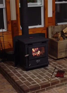

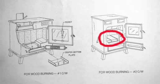

Hey fireman...This only applies if your stove looks like mine....I used to have a Russo stove pictured here. When I moved into my house in 2002 the stove was a mess. I rebuilt it with new gaskets ect.....and the only way to fire it hot was to make sure the firebricks on the bottom (over the shaker grate) had spaces between them. I easily got 400-500 after doing that. And you have to use a fire poker now and then to keep those spaces clean. Also, I had to close the rear damper about 60%. There really is no secondary burn as my model had a really...really.... poor excuse for a baffle. The baffle would fall down if hit with a log or poker by mistake.
Hope this helps

Thanks, woodbutcher. It looks similar, but I don't have bricks on the bottom center portion. It's a steel plate with 6 small round holes for the air. I have to poke a little, usually once an hour, to keep those holes clear or it goes into smolder mode. I'm running the rear damper about 80% closed once the stove heats up after first started, and the intake air 3/4 to full open.
