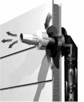

I'm curious, how do the wall thimbles that have the OAK in it get around this? Some pipe I've heard use the space between the outer and inner pipe as the OAK and terminate very close together?

Dr Drum,
I take it this is what your refering to? See attachment.
The cap has a shroud facing the house. Distance is close to a foot with small outlet more with 45º.

nice system i must admit , and carries a UL listing so it must meet code, notice they use a "jet" rather than a "hood" so exhaust is directed away which has to help in the "clean intake" arguement which is the reason for the seperation.
