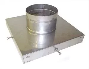

If you want to know what they will use for sealant, ask. One place where shortcuts are often seen is at the top cap. It's out of sight and out of mind. There are simple top caps which are barely more than a hole in a sheet of metal. And there are good caps that have a little curb and collar where the pipe goes through to stop rain from going down the liner. Also, ask if they turn down the edges of the top cap to form a drip edge or do they just plunk it down flat on the edge of the tile. Little details like this make a difference. I would rather pay more for a good worker to take another hour to do a job well, than to pay for someone cutting corners that will cause me grief later on.
References are always a good idea. Make sure they are not relatives or friends.
This is an example of a nice top cap for a terra cotta flue.
