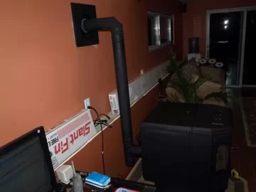

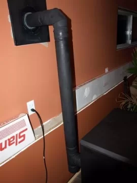

Ok, totally frustrated now. Still getting smoke leak at more than one connection of pipes. Last winter spoke with Simpson tech who told me to put a bead of silicone on the inside edge of the pipe that goes into the double wall of the next pipe. I have taken apart all the pipes and resealed and I still see smoke whisping from the connections. It even looks like it is coming out of the angles of the 90° elbow. I can't run the stove more than a couple of hours before the odor of smoke gets to be too much. Is there a different way to seal the pipes????

If the 90's are adjustable swivel angles they may need to be sealed.
I used red high temperature permatex gasket coumpound and spray painted them with a high temp black to seal my 90's. I have not had a problem with the connecting joints. but I did pull out the rope gasket inside the joint a little to make sure it was touching the other piece.
I to had the same problem....sealed all joints on pipe and elbow, and where the pipe goes through thimble (inside and outside). still had a leak.....then i kept looking and discovered it was leaking from the bottom of the T cap.....foil taped it twice, and no more leak.
Same here, Sealed all joints(inside while assembling and externaly including 90 seams) and tape on the tee cap. I still check them on startup, Just in case!
From my experience, it seems that the cleanout T is the biggest culprit in these installs (too many pieces joined together in one spot). That's the only place I had to add aluminum tape to seal a small leak. All the others seem to be OK just with the factory sealant & twist lock.

Spoke with Simpson rep. He states smoke must be getting between the walls. I told him where I was putting the silicone and he stated it should be 3/4" down the inside of the pipe that goes into the double wall of the connecting pipe. I was only about 1/4" and there is a step right below where I put it. I am taking it all apart again and resealing with Rutland Seal It Right. Supposed to be easy toe get apart so I will even do the T cap. I will let you know how it works.
