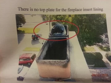

my dad had a fireplace insert and liner installed a year ago. a chimney sweep came to do a cleaning and proposed to my dad that he have the following things done: the guy wants to cut the clay flue flush to the concrete crown, add a top plate as well as cut the jagged metal liner, and finally install a large chimney cap that sheds rain etc from the chimney crown. is all this work really necessary?

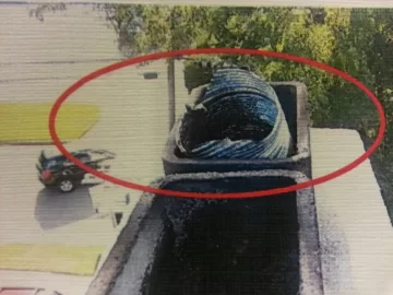

Since it looks as though someone used a rabid beaver to trim the liner, I'm guessing the sweep thinks removing some of the terracotta is the only way he has enough material to make a proper top?
Was he proposing to cut the terracotta on both flues and using a cap over both and perhaps that's why he's suggesting to remove it?
But, at the end of the day the sweep is right, the liner should not be left loose like that.

yes, awful cut for sure.
I think he said he would cut the clay flush on both. and the cap would cover everything... wants 550.00 to do the job. is it really necessary? Or are they trying to rip an 86 -- year old man off?

However, your liner has been cut flush with the clay flue...so that could be the issue at hand and why they are suggested cutting the clay flue down... My rigid pipe comes about 8-10 inches past the clay liner with a cap on top.
That liner is pretty twisted and I'm guessing a twisty tug at the top just might get you enough liner to work with a regular cap.

I would not cut the clay liner flush. He has a serviceable cap already. A plate could be created for protection against driving rain to seal the gap between the metal liner and clay flue. It appears there is enough material left on the metal liner to work with as is.
I would detach the liner from the stove, pull it up, and add a 12" piece of rigid stainless steel pipe to it. Then I would drop it down, attach it to the stove, pack around the liner at the top with ceramic wool and install a top plate with a storm collar and a new cap. Cutting the clay tile down just seems like more work than you could ever possibly need to do.

Buy a stainless "appliance adapter" that is used to connect liners at the bottom to fireplace inserts and a liner top plate. Attach the appliance adapter to the liner after cutting the rough edges off even and then install the top plate and the cap.

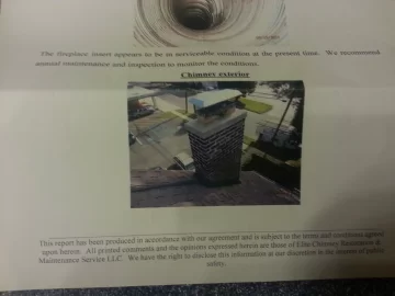

Whatever you do, you should have a top plate on the flue with the liner and a cap for it (liner should be cut evenly). And if the other flue is working it should also have a cap. With two flues in one chimney like that often a single large cap is used as pictured.
But two caps and one plate would suffice. Something like a deluxe terra cotta top plate with hinged cap for the one (no cutting down clay) would be about $150. or so for the material. Maybe $50 for a cap for the other flue. Plus labor. Whether you should cut down flush (and then you can use the less expensive type of flush top plate -- attach to crown (vs. terra cotta top plate attaches to clay) depends on having adequate flue (height) at present and as Begreen indicates if there's a problem with exhaust from one flue getting sucked into the other, a height difference might be a good idea.
