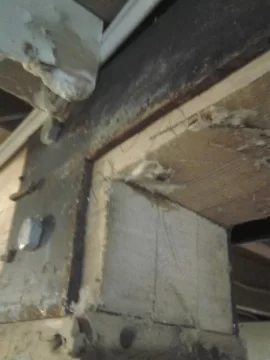

They cut the beam about 3 inches to make 2 taller door ways. And braced it on each side with plate steel (i guess) of about a 1/4 inch.
