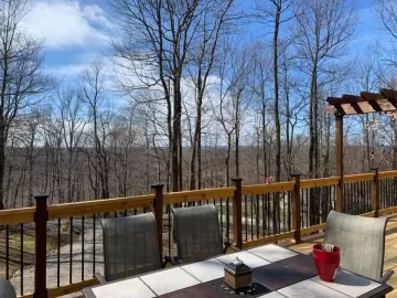

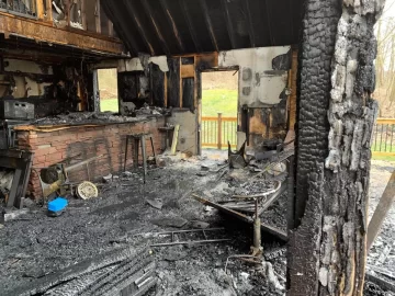

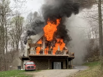

This forum was invaluable a long time ago when I bought a house in the woods and did not fully understand how expensive propane heat would be in a poorly insulated and likely a negligently built chalet home (no inspections here). On Good Friday, we had a massive fire that resulted in a total loss of the house so we are looking to rebuild bigger and better! Normally, I would want months to research every last detail as we rebuild, but I am meeting with a builder this week to hopefully finalize plans. I bought and installed a Quadrafire 4100i myself including the liner inside the preexisting flue about 10 years ago. It wasn't the most exotic stove ever built, but I was able to heat our entire house sufficiently each winter with only 1-2 propane tank fills. For that reason, I plan on installing a much nicer wood stove on the main floor of our new house. I want no parts of installing it myself this time around.
Well, in the last 10 years we finished the basement of the old house but the people that did it did not insulate it well so I had to run a supplemental electric heater to keep it marginally "warm" and keep some of the plumbing from freezing. For the rebuild, I am looking for options to heat the basement other than a stupid electric heater again. This time, the builder suggests a heat pump to heat the whole house (I assume in addition to propane heating?) and the basement will be insulated correctly. I assume there is no possible way to have a wood stove or pellet stove in the basement that runs up a separate flue in the main chimney box but in a separate flue? Initial research seemed to shoot down that idea. I thought about a gas fireplace but that may burn the propane just as fast or a direct vent pellet stove, but I see the issues with soot with a direct vent option. I am not interested in a wood boiler.
I wish I had the time to research this more before asking, but the last two weeks has been crazy. The virus crap has made it even harder to navigate our upcoming rebuild. Hopefully, I'll have my view back again.

Sorry to hear of the fire. That is a very sad sight. I'm glad you are ok.
