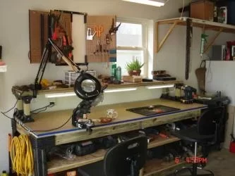

here's how I do mine and if your doing a pretty good job on your chain, and some what clean wood you should be able to get a cord or more with one sharpening. Old timer told me to save my chain work for the shop where there is cold beer...I dont drink much but that statement stuck.

Thats what I need right there is a workbench. My garage is organized chaos but I could set up a small bench in my office with some good lighting.

lighting is the #1 factor and the magnifying glass is sweeet.
Great setup Smokinjay. I agree, save the chainwork for the shop. Keep extra chains with you in the sawbox to replace in the field.
