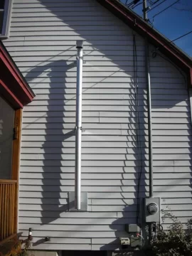

My place
[Hearth.com] Horizontal Install, Anybody have any Problems??

Mine goes up 8'.....but only had the installer do that for my own peace of mind because my oil filler is near there...but I believe the manual recommends a 3' rise at least. Perhaps later I will go above my roof line a bit. But at an 8' rise I get virtually no soot to very little on the top of my rise on the dryer vent cap. I thought I wouldnt like it for the eyesore purposes either.....but it doesnt look to bad.....and my wallet doesnt look to bad either lol.
  • [Hearth.com] Horizontal Install, Anybody have any Problems??
