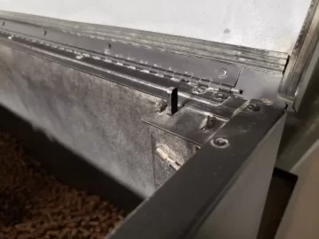

If you had a switch, you would be able to see it where the lid would push it down when closed. Your stove probably senses vacuum. Picture of the hopper switch on my P61a - that tall rectangular piece sticking up
Extremely helpful, thank you. I definitely don’t see a switch like that anywhere on or near the lid, so you must be right. Thanks again!
