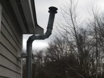

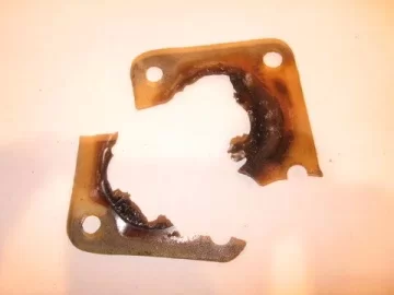

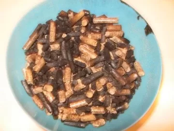

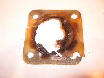

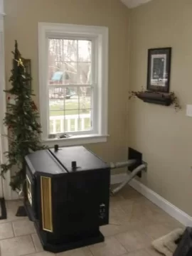

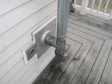

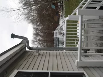

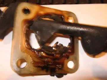

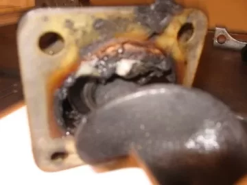

i finalised everything with englander today and my new stove should be delivered in 7-10 days.i paid out $180 in freight.i hav to bring my old stove to a freight center 30 miles away strapped to a pallet.easy drop off ,easy pick up but a lot of inconvenience.again i was very happy with service and cant wait to get the new one.anyone else feel the cold or is it just me.i'm still bothered by what happened with the stove.whats to say it wont happen with the new one,afterall its the exact stove as the one i have.if anyone has experienced fire backing up into the hopper in englander 25 pdv i would greatly appreciate your input.i took some pics today but be patient with me.computers and cameras are not my thing.pellet stoves either by the looks of it.on another note .i've read my manual numerous times since this all happened.a good friend helped with the install and he used selkirk type b gas pipe.my manual calls for simpson duravent .is this an issue and should i replace.pics of vent pipe on the way also.so thankful for this forum and much appreciate all your knowledge and help
