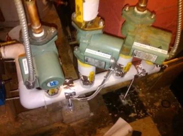

In my opinion, zone valves are not as good as using separate circulators, Relays and sweat check valves.
Below is a picture of the Taco 007 circulators, I have been using for over 25 years without ever having a problem!!
So good luck with zone valves!
P.S. The new outdoor reset controller (Tekmar 260) has a DHW priority feature that pops an error if trying to use zone valves because that feature only works with circulators.
