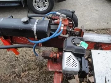

I've been using my friends homemade splitter. He built it with a friend several years ago.....what a beast.

If I understand right they looked at one in a store and welded this thing up. They built race cars so they had the experience and materials to do it. Took a 6.5 hp Briggs and hooked it up to a pump etc. This thing is big…really does the job. Custom pin striping really does the trick LOL.
