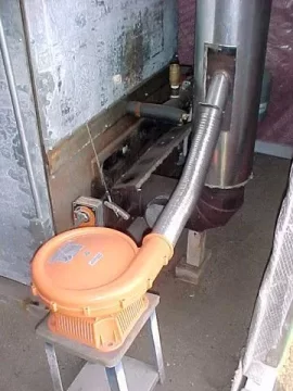

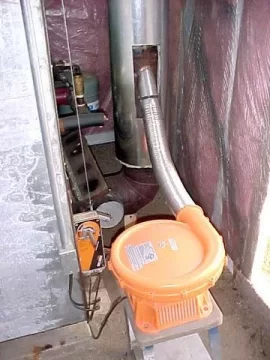

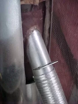

Made a new flu fan, came from one of those blow up wet slides from Walmart. I use it for starting new fires, reloading, and cleaning ashes. Works great, those things put out a lot of cfm.....................just wanted to share...................Jesse

I'd be a little scared with this kind of setup if it's in your house. Have you checked to see if you get any smoke/exhaust coming out of the fan when it's not running during a burn? My biggest concern here would be what happens if you have a clogged flue. You'll end up pushing your exhaust out through that fan. And you may not "see" it.
As long as your burner isn't in the house I suppose there really isn't too much risk. A good way to use what you have laying around.
It's 200' from the house in the boiler barn.............the blast gate seals very well,and with the angle of entry .....near impossible to get smoke/exhaust thru fan.
