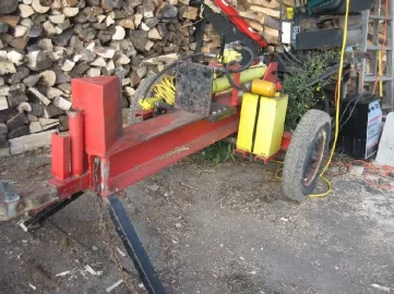

here is an old picture of mine, it now has a log lifter I will see if I can get a updated picture.

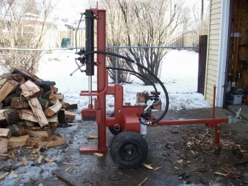

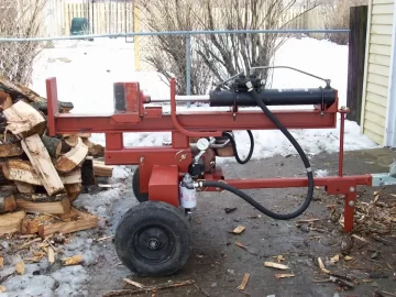

My late FIL built this. I re powered it with electric.

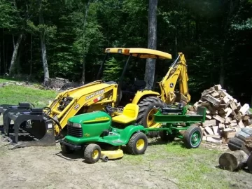

This is a splitter I built with some help from friends. I pull it around with my mower and the hydraulics are powered by my larger tractor. I simply disconnect hydraulic lines to backhoe and connect lines to the splitter. Everything was surplus except for cyliner, control valve, and lines.

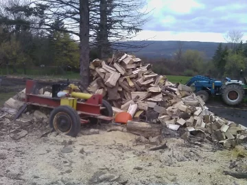

Sorry it took so long getting back. I wanted to have a pic of my splitter.... along with a little backlog of Ash to split.
Home Made Splitters
I need to cut down about 15 more Ash trees so the backlog may grow.

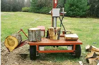

This has been making big logs into firewood for a few years now. Electric start w/log lifter.

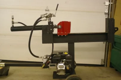

Here's mine. Started life as a Didier.
