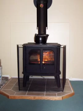

This is a folding screen that has worked fine with our two kids.
I made another cross piece for the top so that if it is pushed back it will be far enough from the stove to prevent a burn. I picked up the screen at a local fireplace shop.
