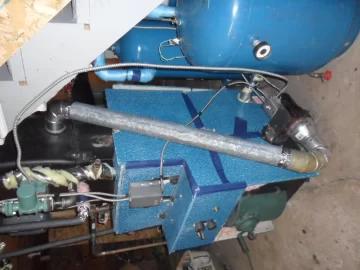

Hello People,been a while but have photo of my boilor working. Took me 4 different times adjusting the air flows in both chambers but think I have it? Takes about 25 minets to get to gasification then around 2.3 hours to heat 170 gal. to 190* With the outside temp. here been upper 30s and 40s this will last me 3 days.

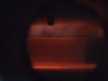

But the second chamber gets very red hot,the firebrick and panels glow bright red, I can adjust air to get yellow to purpel to blue flames, can this hurt the boiler?
