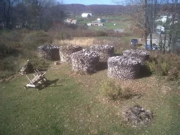

Here is a pic of my HHs:
  • holzhaufen question..help?
