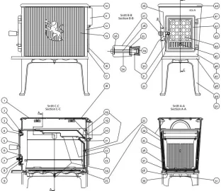

Well, new year, same problems (although *maybe* improved? always the optimist), but tell me if this sounds plausible. I took down the secondary air baffle, which has been jacked up since I bought the stove, and never really fit flush against the cast plate above it. I've been jamming stove cement along the sides and back to try to limit leaks through those gaps. Figured that the worst that would happen would be a loss of some secondary burn efficiency if that leaked into the main chamber. Looking at the secondary air intake on the back of the stove, it's a good sized hole. I'm wondering if the tight seal + small holes on a good part might be the limiting factor on inlet air, rather than the intake on the back of the stove. So leaks around the baffle might let more air into the stove, rather than just having misdirected air. I'm talking about #23 and #20 above it.
