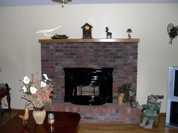

Hi folks,
Attached a picture of our new Hampton HI305 Insert installed. The dealer/manufacturer are taking care of the chip I noted in an earlier post by shipping me a new ashlip. I tested the stove a few times and I think it circulates the heat remarkbly well. I guess the real test will be once the cold weather gets here.
Thanks to all for your input and help with this purchase. I will continue to use this site as a resouce and to share my "pyro" experiences.

Looks very nice! Don't want to dampen things at all, but how much clearance do you have to the wood floor? Hard to tell, but it doesn't look like much.
Thanks, guys.
If you are referring to the depth of the raised hearth prior to installation, MrGriz, it's eighteen inches as per manufacturers specifications for minimum clearence.

That sucker is gorgeous. Keep an eye on that good looking table in front of it though. The radiant heat out the glass will not be kind to the finish on it when it is cranking.

That's what I was referring to. It looks like the insert sticks out onto the hearth a bit and I think you need 18" in front of the door opening of the insert. I'd hate to see that beautiful floor get messed up. My hearth was the same way and I ended up tearing the carpet out in front of it and am going to extend it with tile (it's on a concrete floor, so i'm not in a big hurry).

Thanks. I am a little concerned about the table which is only four feet in front of the stove. My wife polishes it every week and I wondering if a light coat of linseed oil might protect it.
MrGriz,
Thanks for the heads up. After your last post I went back and checked the manufacturers specifications for clearance. they specify eighteen inches of clearance (Canada) sixteen inches clearance (US) from the face of the fireplace to the end of the hearth. They specify eight inches of clearance from the front of the insert door to the end of the hearth. The reason it looks like there isn't much clearance is because the blower and ashlip extend four inches beyond the front of the door.
As far as the floor, not to worry-it's just Wilsonart laminate- lol!
