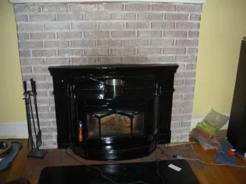

Hampton HI300 was installed on Tuesday morning by fireside supply from Hebron CT. The guys worked really hard to fit the insulated 5.5" liner down the 1929 8*12 29' flue with misaligned tiles . They succeeded and had to take a few fire brinks out of the fireplace to get the insert to fit flush with the fireplace. Inspector came today and signed off on it. I burned a couple small break in fires on Tuesday and we're burning a few splits at a time tonight. This thing is great, really heats up the whole front part of the house. Now to get a couple thermometers so I can make sure I'm not burning too hot!
