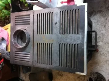

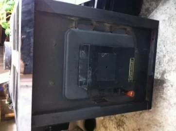

Hello,
I just picked up a "hevac automatic wood heater" for 50 bucks and can't seem to find any info on it anywhere...
It's a "Super Chalet" mod# wc-220
I'm looking for a manual or really just anything.

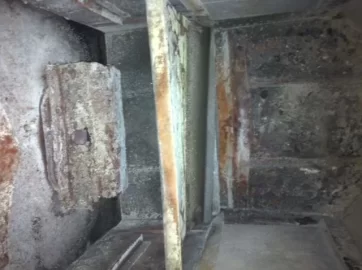

I wonder if the issue with running it cleanly is due to the multiple baffles? I don't really know anything about what goes on inside a stove...(other then there's a fire burning)
The picture below shows a plate which covers about a 3rd of the fire box area.(plate can be removed, it just kinda fits in there) Above the plate there's a baffle covering the flu opening with two golf ball sized holes.
I would guess the lower plate is to suppress flames lower in the box and aid in burning up smoke? The baffle around the flue seems to restrictive? I wonder if there's any harm in removing it?

I'd leave the bricks in. They should protect the outer walls and keep the fire burning hotter. Be careful with clearances. Sauna stoves are usually in close quarters with wood close by. For sure go overboard with heat shielding and have a safe flue system.
