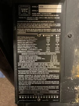

Blowers are optional accessories for this model. The only evidence that this ever had a blower attached would be the mounting holes on the lower rear of the unit.Well there is no electrical cord on this thing and I can’t find a plug socket anywhere on it. No blower assemblies either. The guy told me had a blower but I sure can’t find it. Still trying to find fitting that work on it to connect to a grill tank.

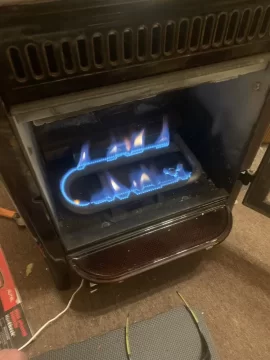

The white material is a byproduct of incomplete combustion. It usually occurs where the burner flames impinge on the logs.Can’t seem to edit my post above. I was also wondering about the log placement. Is that critical. Couldnt get them in the way they were before earlier today. Also they don’t look like the same logs in the pic in the manual. I’m probably overthinking this.
Ok thanks. I’ll keep working for a better fitting. The manual has no direction on how they go. There on only two pieces and the first piece has a witness mark from the pilot so I’m pretty sure how it goes so that only leaves two positions the other one can go.

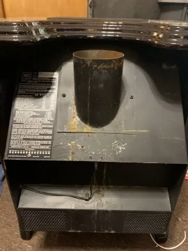

That's exactly what I needed. I'll get up on the roof tomorrow and measure the pitch. Thanks(503.6.5) Gas Vent Terminations | UpCodes
