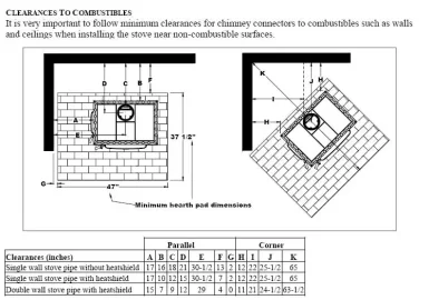

When my husband & I ordered the Heritage, the sales rep wrote us up for a 48" corner pad (Graysen). After seeing the price of the pad, we decided to shop around to get a better deal. We found a 48" corner pad which measures 60" from corner to front of the pad. After bringing it home I went on Hearthstone's website and discovered the measurement should be 65". Should we get a larger corner pad, or will the installers move the pad 5"away from the wall? I don't recall seeing any extensions at the local hardware store.
Also, I am concerned about accessing the side door if the stove is 12" from the wall as recommended. The sales rep said that there will be enough room, but I'm having a difficult time visualizing it! Although we prefer that the stove is located in the corner, would it be better to have it on a straight wall?
I appreciate any suggestions because I don't want the installers driving 60 miles to our house and then say "Oops...you have the wrong size pad!"
