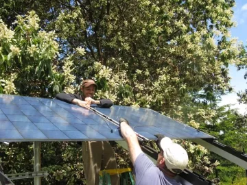

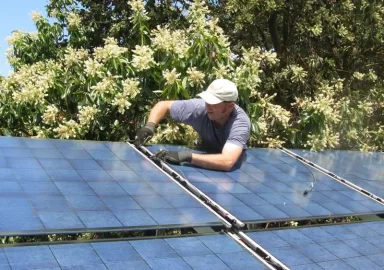

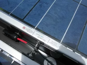

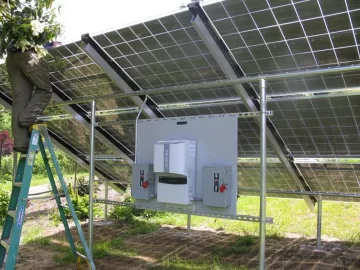

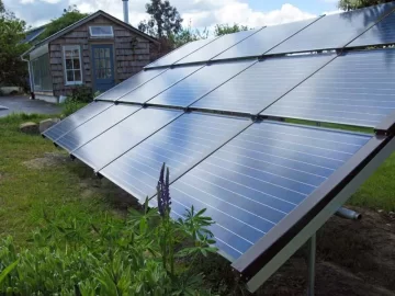

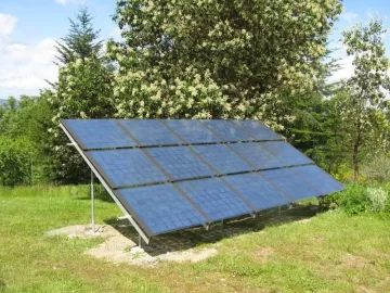

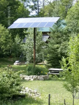

Well, I can be an optimist, can't I? We're making good progress here and hope to be online in a week or so. The 4x4 panels are made in WA by Silicon Energy. They mount an Aurora inverter on a panel board with switches so that it qualifies also as a made in WA system. This puts us in the WA top tier for annual energy credits at 54 cents/KWh produced + 10 cents/KWh net metering = $.64/KWh. This is a 3KW array, but we are wiring it for expansion if there is a technology leap in photovoltaics in the next few years.

How long do you figure it'll take for you to fully amortize the initial capital expenditure? Rick
Wow!!! Keep us updated on how it is working out.
I would love to have that sitting at the end of my drain field aimed South.
10.5 years. The way I look at it, it's a 10 yr cd at 8% interest. After that, it's all gravy. It's the best guaranteed investment rate I've come across in awhile. That's outside of the intrinsic enjoyment. It's so cool to have the house powered by the sun in summer. I've wanted to do this for years, but had to wait for made in WA products and the legislated incentives to be settled.
The folks that put this in did exactly that for a retired Boeing engineer that lives a few miles away.
Nice! Looks like no shading problems there.
Nice looking installation. We share your optimism!

Awesome. That's a tower of power!
Be Green
Well done!!
That is great.

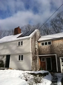

Here is a pic of my DHW Solar Heater: Hoping to turn off oil burner every Spring Fall Winter

Excellent. We are thinking of solar hot water too if I can figure out how to retro-plumb it into the house without making it too noticeable. How did you make the runs to the hot water tank?
Be Green
Through roof and attic, into guest room closet, then closet just behind front door, then down into basement, turns the corner and home free...
Another option would have gone down the R hand side near all the telephone and electric wires but in cold winter they told me this would have
decreased efficiency. Plus my better half did not like the idea of pipes draping down the side.
Tom

Hi BeGreen, how much did your system cost? just trying to work out your 10.5 year payback. I have a 4.56kw system, it cost me $12,500 and should be paid of in 4 years. We export 80% of the power at 47cents/kw.
Yes, very different economics here. These are premium panels and cost more. I could have saved a lot going with Sanyo or Sharps, but then I would not get the made in WA rebate. That would have dropped my grid-tie return to 15 cents/KWh. Same with the inverter panel system. And I was not comfortable with plastic backed panels or exposed wiring. I need rodent-proof in this location.

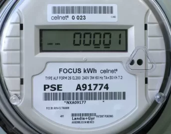

Production meter installed, we be grid-tied. Here's our first kilowatt!
