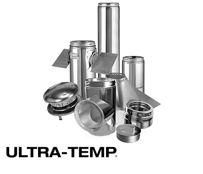

Selkirk Ultra-Temp 4" chimney pipe is sold in Canada. Check with them for dealers.
