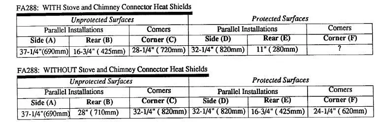

I have a CDW 288 like new, I am goig to install. Need some sugestions?
I will be installing all new 8 in chimney, hearth, Wall protectors, coal/wood burner
I plan on setting stove in a corner. I have 9 foot ceilings and the walls are 1/2 in drywall, outside should clear soffit and go above roof easily at the far wets corner of my home. I have all the teck manuals but I get confused when I read the Pipes Manuel???
Floor & wall spacing/ coverings any ideas?
If Possible I would like to build my hearth & wall protectors
Chimney DSP/ DVP double black or stainles or triple wall?
