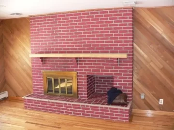

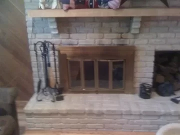

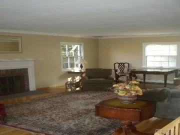

Both fireplaces are full masonry fireplaces with chimneys. I have attached some photos of the fireplaces.
The first 2 photos are of the same fireplace, the brick was repainted. The original owner had painted it red and grey.
The 3rd photo is of the living room.

Those are really nice looking fireplaces.
The one in the family room would be fine with the C350.
The living room looks huge. Consider something significantly larger than the 350 for that fireplace.
Thanks Six, unless the jury is still out, I will order the C350 tomorrow.
